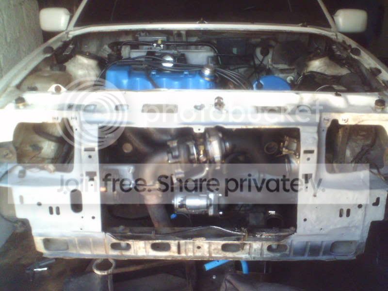

Something about Zetec Turbo engine:
When I bought the car it has classic CVH engine 1,6 with 8 valves, garrett T3 turbo and mechanical fuel injection. Original RS Turbo engine. This engine was bad from the beggining so I try to rebuild the original engine with no interferences to the inner parts. It wasn't so good idea and the engine was demaged. I start to find what type of engine is possible to get to the car and I find that the 130hp 1,8 16v Zetec is pretty easy to implant to the car and that it's not so big problem to turbocharge it. I find pretty good engine with low mileage and I put it into the car. It was in time when me and my mate bought about 5 pcs of RS Turbo cars in bad conditions but wit lot of spare parts for rebuilding. So I had the zetec engine and garrett T3 at the same time in the same place. I wanted to build the engine better then the CVH before but It's pretty expensive to buy pistons and lot of parts for building strong and powerfull zetec turbo engine so I bought another one for rebuild. I want to get about 200Hp and It doesn't need to change the internals. Turbo engine needs different compresion ratio so I change it with decompression plate and two custom build head gaskets. Inlet manifold was rebuild from MFi XR3 version because I like the shape of it. It was modified for connecting Fiesta RS Turbo EFi throttle body, EFi injectors and EFi fuel rail. I made a spacer plate for fitting the inlet manifold to the zetec head. Exhaust manifold is made by me and the vernier pulleys too. Ok.. the flanges for the exhaust were laser cutter by company and the vernier pulleys was made by my lathe operator (miller) but It's designed by me like many parts on my car Intercooler is used from Avia (It's a Czech truck). It has pretty good shape, It's working and It costs about 70-80€. Next parts I have prepared for the engine is brand new iridium plugs with cables, brand new belt and pulleys, water pump, HKS SSQV blow off valve. Intake, rocker cover and fuel rail are black wrinkle coat painted. The engine is still out the car and I need to get some other parts: alloy rad because the IC has one outlet in the same place like original radiator. So the full alloy rad will be modified specially for my car. Next part I need is fuel pressure regulator and some pipes and hoses for connecting. These parts I will be buying first because I want to get the engine to the car this year as soon as possible.
Exhaust system is 2,5" pipe with no catalyst and Sebring Hot Steel back box with 4" outward rolled tail pipe. It sounds like WRC car.
Most important part is management. I bought fully programable MegaSquirt control unit with 3bar mapsenzor, wideband O2 senzor for mapping the unit, uprated beige injectors usedable to 220 Hp. I had the complete Efi management from Fiesta Turbo with cables and senzors but the control unit will be changed by MSQ one.
I want to build low cost zetec turbo but I spent a lot of money now. If it will be working fine I will made the second engine with decomp pistons and other expensive parts.
Gearbox is original from Turbo with limited slip diff.

to 12cim:
Sorry mate, I forget it
The oil leading is from the back side of the engine to the turbo. It's the same like RS Turbo CVH engine and the same oil braided hose. Check the stainless steel braided hose on the pic, I hadn't my own pic. There is an oil pressure switch.
This hose is going to the turbo and from the bottom of the turbo there is a pipe going back to the engine. I have welded an intake part on the oil sump for connecting the pipe from turbo and the oil sump by hose. It's absolutely same like CVH RS Turbo engine but CVH has this inlet pipe insert in the block and not in the sump. It's not so difficult thing in turboing NA engine.
For better cooling the turbo is possible to get the oil cooler between engine and turbo. I will be using small OC fitted in front of gearbox for it.

Here are some more interesting pics:
with Keskins KT-1 wheels
CVH engine
exhaust manifold
IC:
Dashboard with gauges (air/fuel ratio, oil temp and pressure, voltmeter, boost and escort mk7 dials):
MegaSquirt and Wideband O2 senzor:
Stainless steel decompresion plate and 0,75mm head gaskets:
Vernier pulleys:
Flange for fitting CVH intake to Zetec head:
Intake with welded flange for Fieste RS Turbo throttle body and Efi injectors:
HKS SSQV Blowoff valve:

That solution for the exhaust manifold i've seen it on 2.0 Mivec (Mitsu'), on C20LET an so on ...
Interesting option for turbocharghing that engine, i was on the brink to do this step also, but on a Duratec engine with a kit provided by focussport, but after some research i've concluded it isn't a good choice due to the engine overall construction .... so, it remaind aspirated.
What cams do you use ???
With that T3 those fuel injectors are adequate ? (no need for bigger ones or a new fuel pump?)
for the megasquirt ...
NWZeu is offline   Reply With Quote
Old 17-01-11, 22:19   #15
mariS_ZTi
Join Date: Jan 2011
Posts: 8
Default Re: Ford Czech Escort mk4
I don't like how the standard exhaust manifold looks so I build somethig what I think that will have better airflow. It has same long lines and it has flanges at the same places like standard ones. So I will use standard exhaust from turbo. I know that I didn't find America.. It's only exhaust manifold and it cost me about 15€ and 3 afternoons of measuring, cutting and welding.
Duratec engines are pretty good for turbocharging so You can try it. If You have possibility to get the engine for good price let's do it. I'm thinking that the second engine I will build if this first will be working fine will be 2,0 zetec. It's easier to get low comp pistons, rods atc. Decompression plate isn't good way to lowering the CR if You need more boost pressure. Better way is using right pistons, cometic head gasket, ARP bolts.. But I want to make the engine about 200-220Hp in 0,8 bars of boost only for the lowest price.
Cams will be standard for the momment but my mate has NA 2,0 zetec engine with 200Hp and He is going to build something more powerfull. I would like to buy this engine and turbocharge it better way. The biggest contribution of power increase is created by the bike throttle bodies and trumpets. His engine is working with MegaSquirt like mine so the better maping has power increase too. And last thing of power increase was my vernier pulleys. He is using my owns on his race engine
My beige CVH injectors are usedable to about 220Hp what I want. If I ill need more power I will change them for something bigger and I will remaping the ecu. But 220Hp is the top of engine power with standard internals. These beige injectors are using with remapped CVH RS Turbo engine with power I said.
New fuel pump will be of course. Bosch racing pump with bigger capacity and fuel pressure regulator. And MSQ ecu will be mapped for right values of fuel pressure, air pressure from map sensor and A/F ratio from O2 sensor. This is basic for turboengine.
MegaSquirt is hell in alloy box. I absolutely don't understand of electricity. My mate is MAN in electricity so he will do it for me. My mate with racing engine will prepare the ecu with basic program and the second mate will put it to the car with all of loom, cables, sensors, gauges, lights etc. It's not so easy I think it would be but it's not impossible to finished it.
