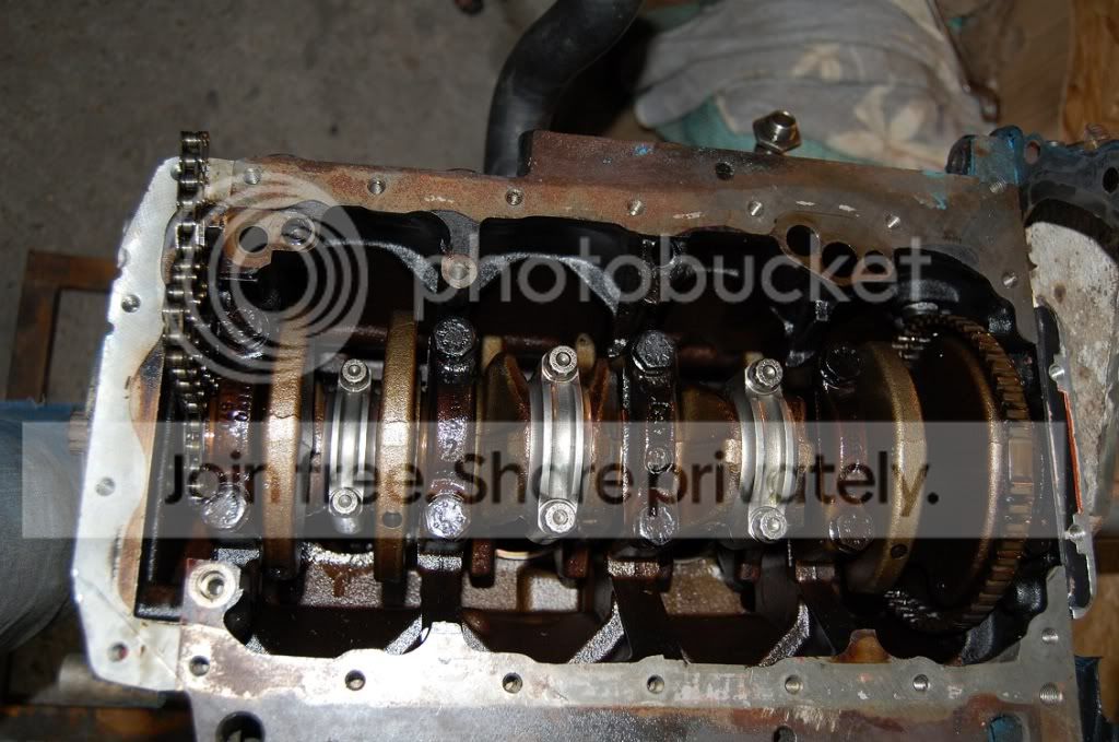

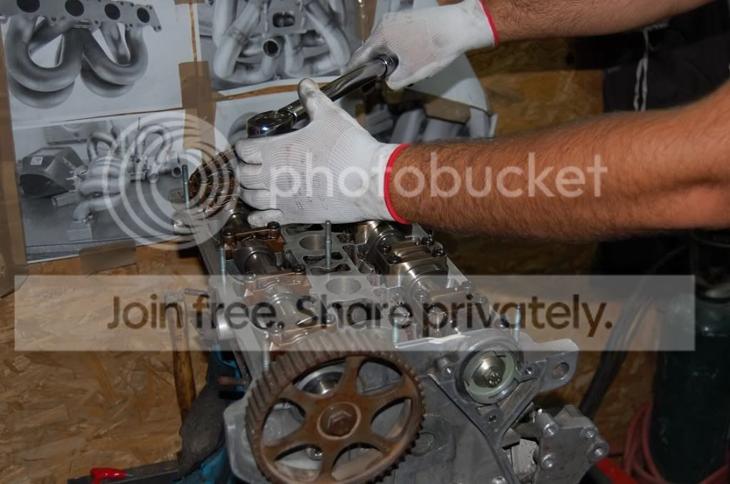

O masina care o am la suflet....pun niste poze cu montajul motorului. :)
https://i628.photobucket.com/albums/u...m/DSC_8671.jpg
https://i628.photobucket.com/albums/u...m/DSC_8674.jpg
https://i628.photobucket.com/albums/u...DSC_8676-1.jpg
https://i628.photobucket.com/albums/u...m/DSC_8673.jpg
https://i628.photobucket.com/albums/u...m/DSC_8676.jpg

EUGEN si noi te avem la suflet fratioru,mersi frumos de poze,o sa mai dam axele jos cand punem ce trebuie sub ele;)
