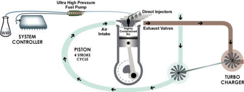

Referitor la turbo
Boost . Boost is pressure above atmospheric , measured in the intake manifold .
Bypass valve . The bypass valve permits a bleed of flow around the turbo when the engine is not under boost.
Crossover point . This is the point at which manifold boost pressure equals turbine inlet pressure.
Detonation . Detonation is spontaneous combustion of the air / fuel mixture ahead of the flame front . When pressure and temperature exceed that required for controlled combustion , the mixture autoignites . The metalic pinging sound is the resulting explosion's shock wave colliding with the cylinder walls .

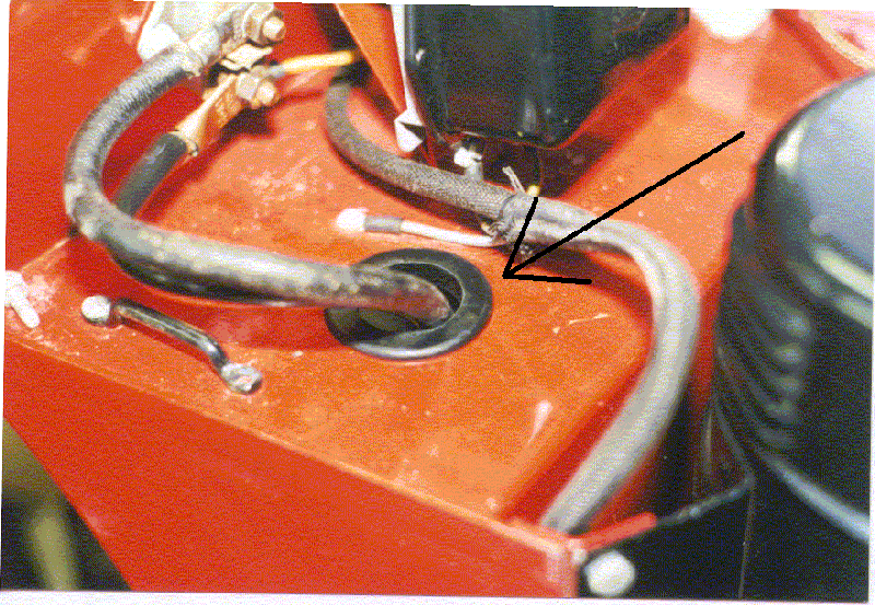

grommet? ce inseamna?
Flow 16-04-07 23:58
Re: Termeni tehnici utili !
Grommets and eyelets are metal, plastic, or rubber rings that are inserted into a hole made through another material. They may be used to reinforce the hole, to shield something from the sharp edges of the hole, or both.
https://forum.4tuning.ro/imagehosting...3f04a8603c.gif
de obicei se gasesc pe gaurile de pe caroserie care se afla intre motor si habitaclu , care impiedica frecarea intre cablu sau camasa si caroserie prin protejarea cu acest ''grommet''
alea pe unde ai vrut sa tragi cablurile de la statie si n a mers :lol:
blondu_glf 2 17-04-07 14:46
si traducerea in romaneste ar fi presotupa din cate stiu eu.........daca nu m-am exprimat corect sa ma corecteze cineva
cu "e "sefu' ai spus bine, in romaneste se numeste presetupa..
