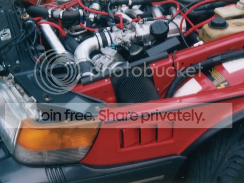

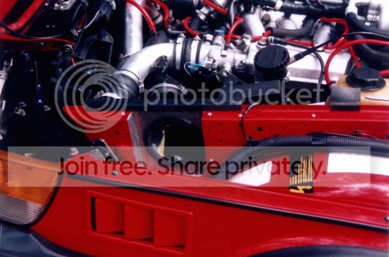

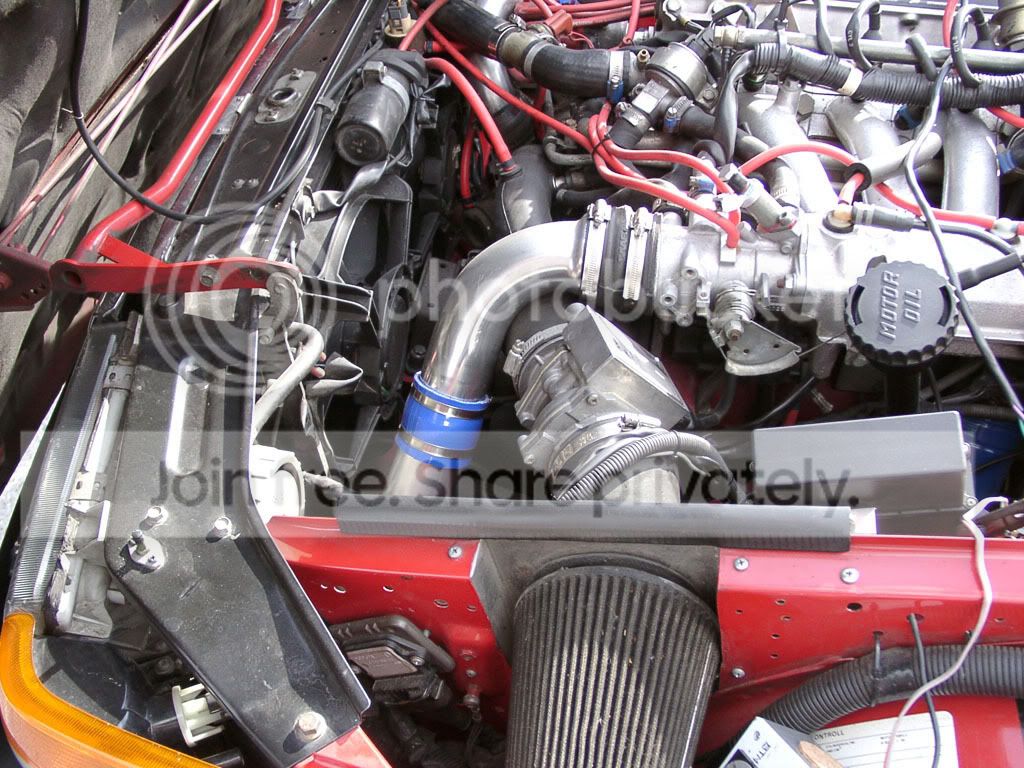

Originally Posted by Red91StangCT (Post 686996)
Daca puneti filtru sport, puneti o teava care pune filtru in aripa, no sub capota
https://i170.photobucket.com/albums/u...000/th_3-3.jpg
https://i170.photobucket.com/albums/u...000/th_2-6.jpg
https://i170.photobucket.com/albums/u...000/th_1-8.jpg
